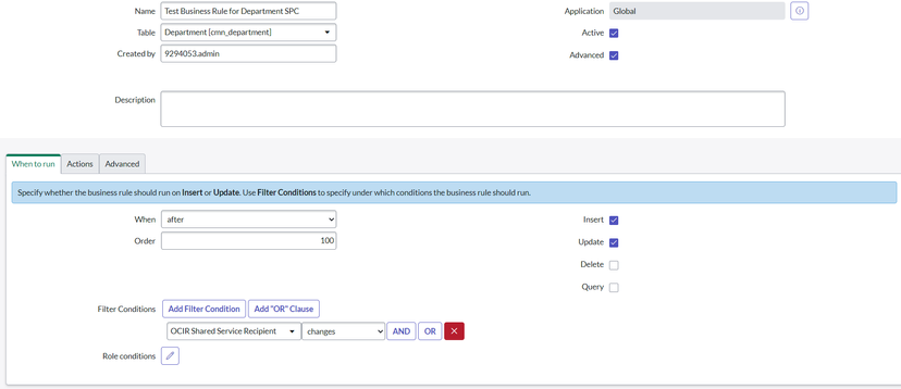

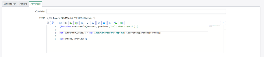

The business rule to trigger this:
I'm wanting my my script include to refer to the current SPC records that are being updated by the affected department record. Does anyone know how I do this? The background script works because I've specified the Provider and Capability fields, but how do I do it in a script include where it refers to the current values?

I'm not sure if "current" is a reserved keyword. Maybe try renaming it in your script include to something else?
Or maybe you could edit your Business Rule to send 2 parameters like this:
var currentSPCDetails = new LBGSPCSharedServicefield().currentDepartment(current.u_provider, current.u_capability);
Hi @JenniferRah  In my business rule, I've done the following:

The department table does not have a field called capability or provider as they come from the u_cmdb_ci_capability_provisioning table
When you send the current.u_provider to the script include, it sends the sys_id, so you don't need to do provider.getValue('sys_id') in the addQuery statement. You just need to use provider and capability. You can do a gs.log statement above it to show what is being sent if you want to be sure you are getting the right info.
I just noticed you said this:
If the current record that the business rule is running on doesn't have a capability or provider field, then none of this will work. You are trying to use that record to do your query, so I'm confused as to what you are trying to search on.
