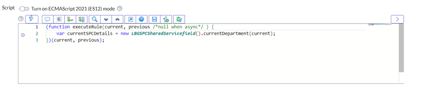

The business rule to trigger this:
I'm wanting my my script include to refer to the current SPC records that are being updated by the affected department record. Does anyone know how I do this? The background script works because I've specified the Provider and Capability fields, but how do I do it in a script include where it refers to the current values?

So I've written it like this:
However, I need to know how do I get the value of Shared Service from the u_cmdb_ci_capability_provisioning table updated for the current record? At the moment, it only seems to work if I specify the actual sys ID of a u_cmdb_ci_capability_provisioning  record or the Capability and Provider set for a record.

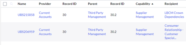

The Shared Service field should always be true if there are multiple records with the same Provider and Capability:
For the below example when there is only one record, the Shared Service field should be set to True if the u_ocir_shared_service_recipient field within the Recipient field is set to True. If the u_ocir_shared_service_recipient field is set to False, then the Shared Service field should be set to False.
