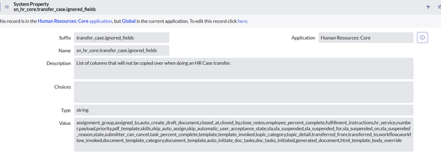

When you are transferring a HR case, all the fields are getting copied to the newly transferred case expect the fields which are listed in the 'sn_hr_core.transfer_case.ignored_fields' system property. You can refer the below screenshot and make the respective changes in this system property.

Hi @Pratiksha_45,
