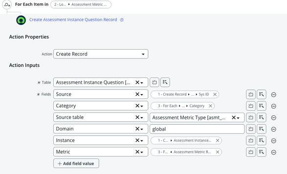

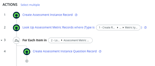

I did the same and had the same issues. Instance created, but questions are not generated. Extend the flow with the following:

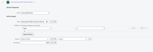

  1. Look up records in table [asmt_metric]. Condition is Type is 1 - Create Record > Assessment Instance Record > Metric Type

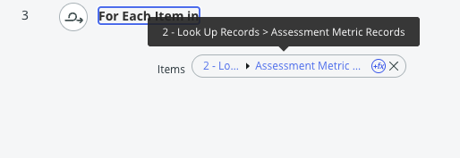

  2. Add a flow logic For Each Item In:
  3. For each item create a new record:
    1. Table = Assessment instance question [asmt_assessment_instance_question]
    2. Fields:
      1. Source =  1 - Create Record > Assessment Instance Record > Metric Type > SyS ID
      2. Category = 3 - For Each > Assessment Metric Record > Category
      3. Source Table = Assessment Metric Type [asmt_metric_type]
      4. Domain = global
      5. Instance = 1 - Create Record > Assessment Instance Record
      6. Metric = 3 - For Each > Assessment Metric Recorddkliffen85_3-1758024884862.png
This worked for me. Let me know if this worked for you.
