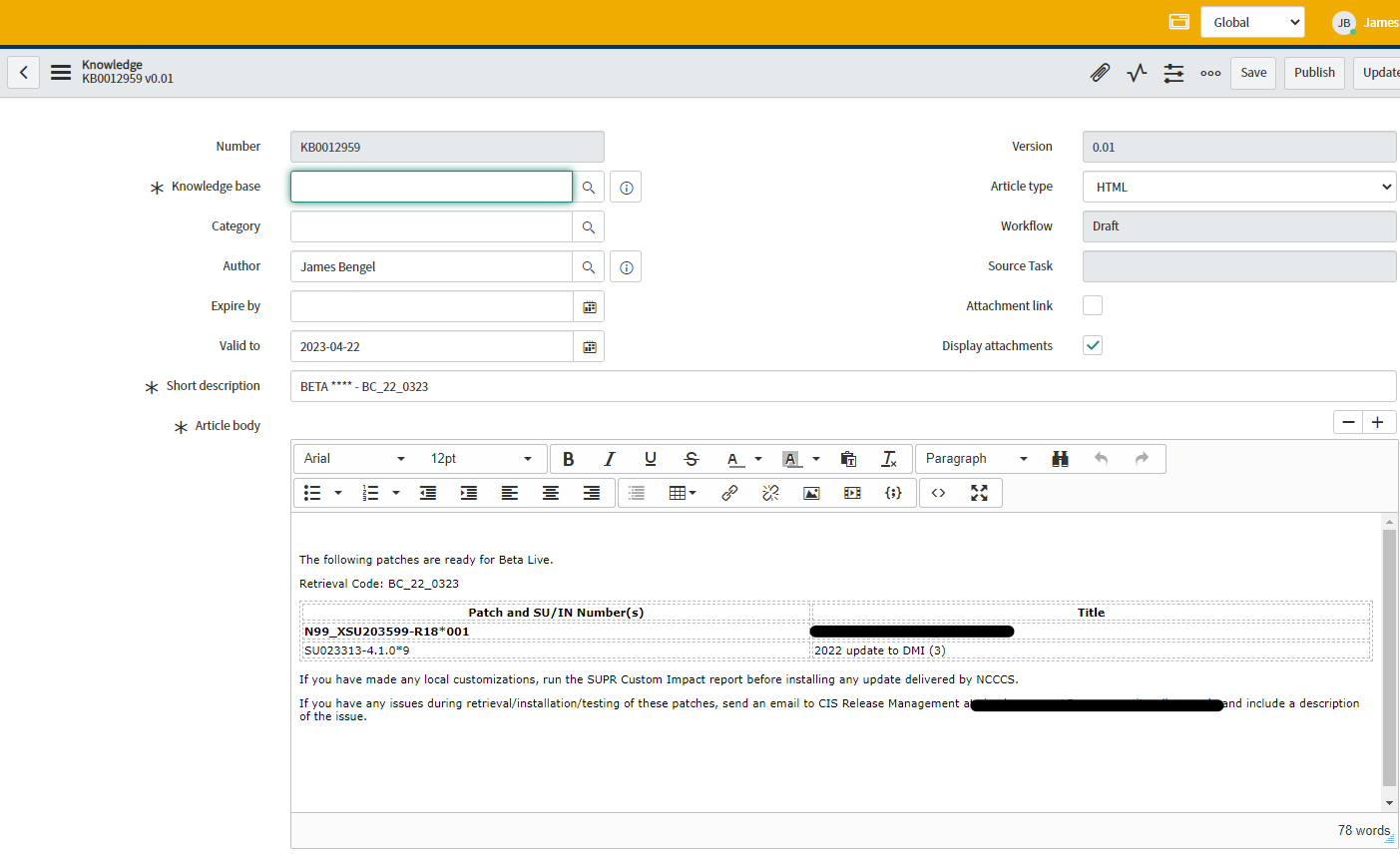

If we look at it in the editor we can see the table:
And if we look at the source code we see what the script hath wrought:

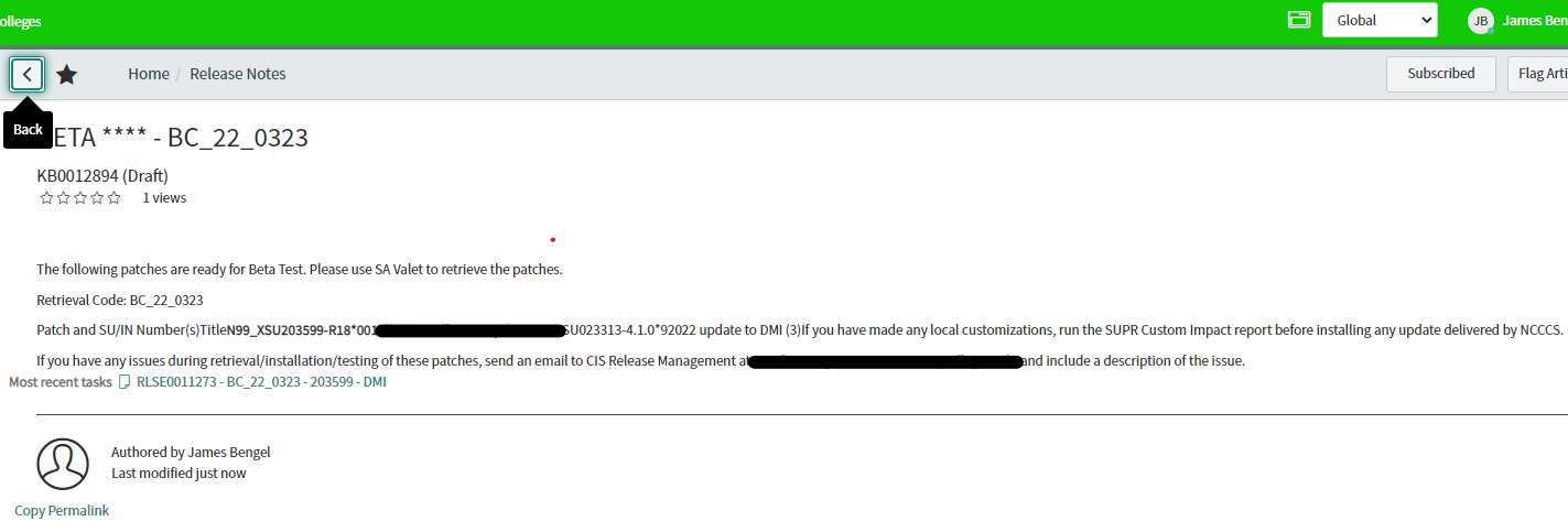

If we do the same thing with the same release in Dev (remember that both of these were cloned form Prod, so we have them in more or less identical states) we see something that isn't at all like what we expect:
The entire table -- headings and all -- has been condensed into one line. Whic hbecomes obvious when we look at it in the editor:
And even more obvious when we look at the source code:
The <table>, <th>, <tr>, and <td> tags were all replaced by a single <p>aragraph tag when the record was created.
