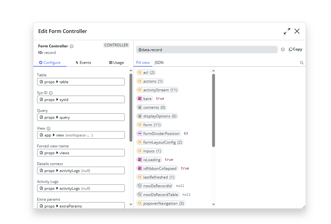

Hey Thomas,
No unfortunately SN did not resolve the issue, however they have changed the look-and-feel of UI Builder interface with Washington release and the data binding is now done differently (see screenshot). We haven't experienced the data binding blinking issue with the updated UIB (so far).
