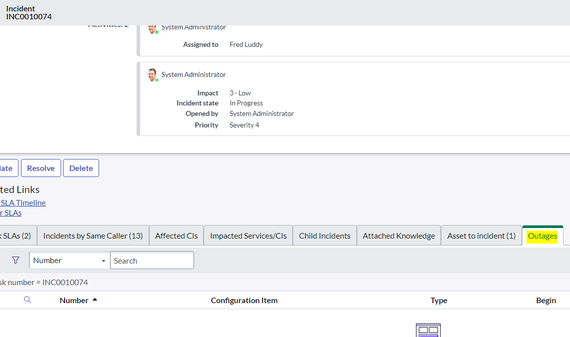

I added on Related list "Outage" for incident as you can see in below picture, but i am unable to find relationship of this related, I really want to know how this related list working, and how it is created.

Hi Danish,
Its not m2m table, i want to gain in-depth understanding of this.
How above highlighted related list configured, suppose if i want to create similar related list to relate incident with new table 'y',how to do it.
01-14-2024 03:52 AM
Hi @Sachin G K1 ,
the related list outage is related to the table task_outage where there is a m2m relationship between task table and cmdb_ci_outage table.

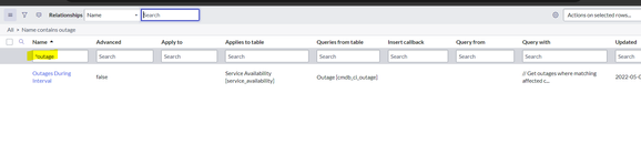

Under List Control, I saw that the Related list field is populated as "task_outage.task". Then, I went to the Relationships table to search if there is any related list which queries from the "task_outage" table. I didn't get any matches which makes me think what @Danish Bhairag2 said may be correct.
"If directly the outage table open then there is no specific relationship created. it's just the field present in outage table have incidents field which is referencing to incident table."
