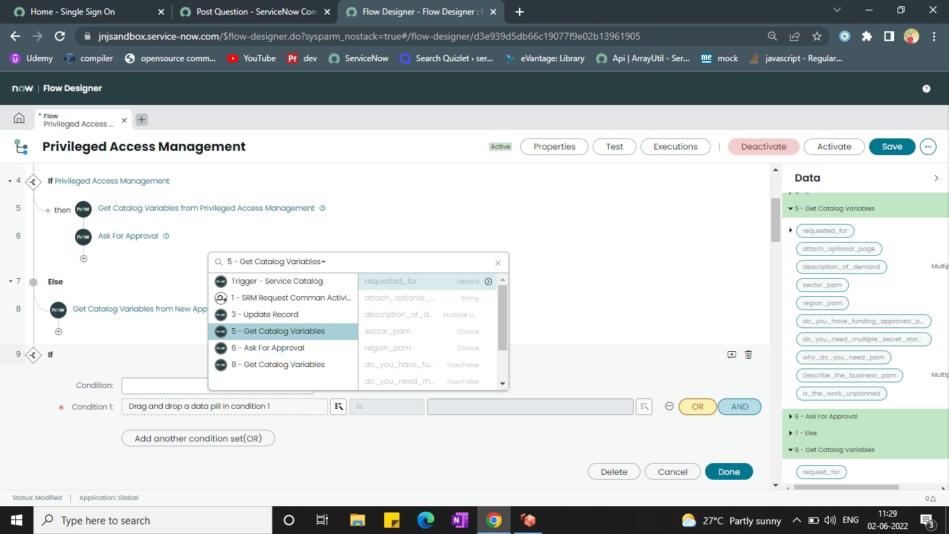

I am unable to get variables in step 9 fetched in step 5 or 8.I have moved variables from available to selected in step 5 and 8. But still issue exist. Please guide me.
Thanks in Advance,
Sachin

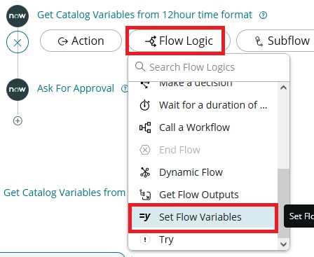

Hi Sachin,
Flow Designer only allows usage of data pills inside the scope. That is, variables declared within the if statement can only be used within the if branch.
To usage variables defined in the if branch after the if branch, create a Flow Variable.
After getting the Catalog Variable, add a "Set Flow Variable" to set the catalog variable to the Flow Variable.
Then, use the flow variable in the if statement in step 9.

Hi Ankur,
lets say, i have fetched location variable in step 5.so in step 9 i want to check if location is india.
06-01-2022 11:39 PM
Is location variable a reference variable?
why not use lookup record on location table and then use output of Lookup record in the IF Action

Hi Sachin,
