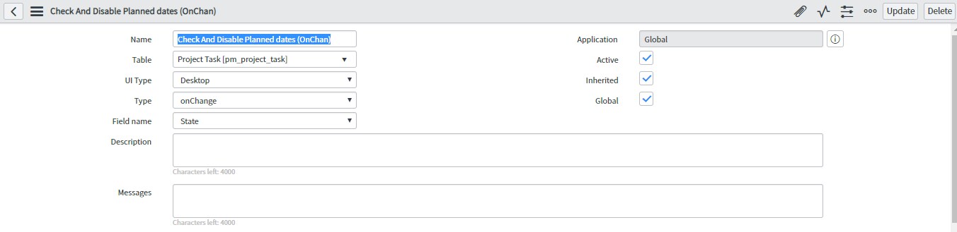

Perhaps this could be the one causing the trouble.
Here's the script:

There you go sir. Good find. Looks like there is some onChange variable value which causes the form to be disabled for planned start date. I would not be very much familiar with your environment and why this client script would be running . You might have to get in touch with the business stakeholders or developers to see what is the business purpose of this script.
You can definitely disable this client script and then import the data but not sure if this can disrupt the normal business processes.
Please mark this answer as correct and close this thread so that others can benefit from it.
