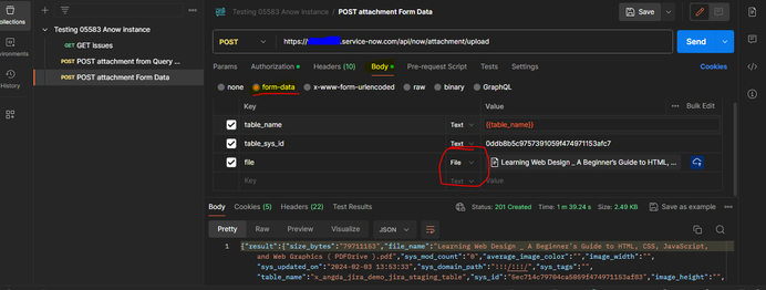

So, I have reproduce your steps in my instance.
I think you should also follow the same, I guess the version of POSTMAN you are using is not current version so just upgrade it or use the current version of Postman here is the steps that I followed.
Inside Body ---> Form-data ---> file (File) type.....
Authentication used : Basic
Also no need to configure Header in this case rather
Inside Authorization....
Step 1:
Step 2: Hit that send button...... yessss....
Here is the Sample response....
{"result":{"size_bytes":"79711153","file_name":"Learning Web Design _ A Beginner’s Guide to HTML, CSS, JavaScript, and Web Graphics ( PDFDrive ).pdf","sys_mod_count":"0","average_image_color":"","image_width":"","sys_updated_on":"2024-02-03 13:53:33","sys_domain_path":"!!!/!!!/","sys_tags":"","table_name":"x_angda_jira_demo_jira_staging_table","sys_id":"5ec714c79704ca5059f474971153af83","image_height":"","sys_updated_by":"saurabh.dubey","download_link":"https://--------.service-now.com/api/now/attachment/5ec714c79704ca5059f474971153af83/file","content_type":"application/pdf","sys_created_on":"2024-02-03 13:53:33","size_compressed":"65839905","sys_domain":{"link":"https://ven05583.service-now.com/api/now/attachment/domain/09ff3d105f231000b12e3572f2b4775d","value":"09ff3d105f231000b12e3572f2b4775d"},"compressed":"true","state":"pending","table_sys_id":"0ddb8b5c9757391059f474971153afc7","chunk_size_bytes":"700000","hash":"d883135a99f1a005006888d0dd2654630b7bcf95059f5b63d145dd589971fda8","sys_created_by":"saurabh.dubey"}}

@SaurabhD8867250 I have seen above post and several other posts and none of them have a working solution 🙂
Alright @Suggy  may I know the step that you followed from POST man to reproduce the steps.
I followed these steps:
and got below error:
"error": {
"message": "Failed to create the attachment. File part might be missing in the request.",
"detail": null
"status": "failure"
