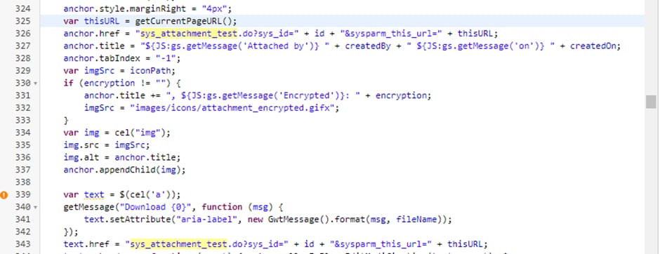

As far as I know, on the System UI > UI Pages,  be able change Request URL to change Action of attachment record. (shown image below)
And also on the System UI > UI Macro, change Request URL to Modify XML of attachment_entry record. (shown image below)
To my knowledge of modifying steps, changes are possible. (shown image below)
But when using Drag and Drop function, CAN NOT modify Requested URL & Uploaded files of Download links that records on activity stream.
