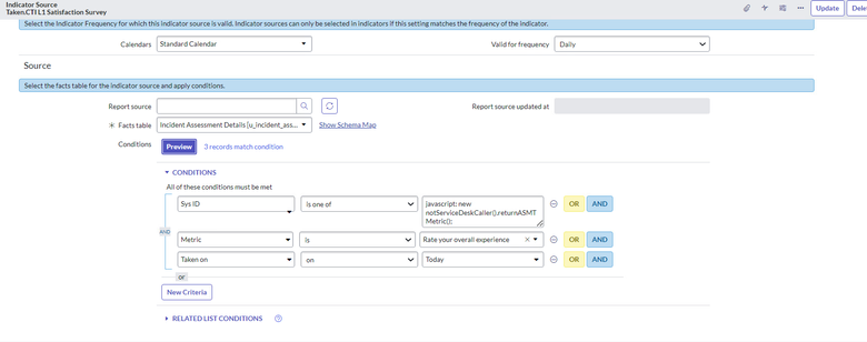

This is my indicator source. The table is a custom database views table (will that impact the script include's ability to work correctly?) and in the conditions, the first line is my dynamic filter that's calling my script include called "notServiceDeskCaller". The goal is to only get records where the incident's caller_id is not a member of a particular group, along with some other conditions. As you can see, I should be getting 3 records returned for today, which is correct. I've also looked at what I should be getting for last month for testing purposes once I run the jobs, and the preview tells me 3 for March as well.

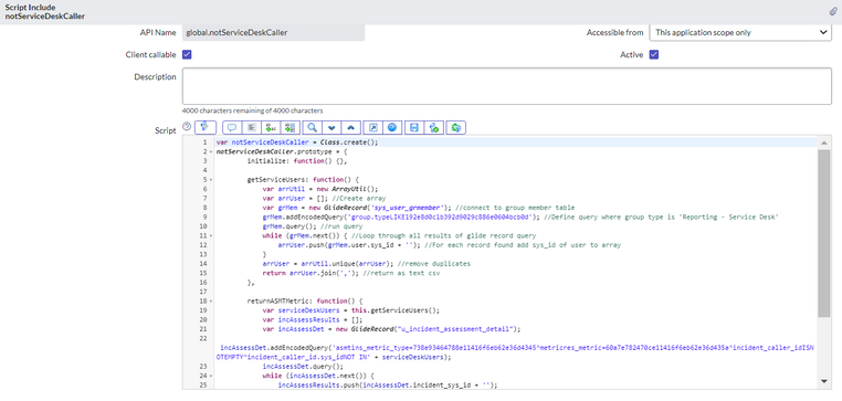

And this is my script include. When I run my historical job, for the month, unfortunately I do not see the 3 records I was looking for in my Scoresheet, even though I see it in the preview. Any ideas why my script include isn't working? Thank you!

Based on the script include code you provided, it seems that the issue may be with the query you're using to filter out incidents whose caller is a member of a certain group. Specifically, it looks like you're using an encoded query to filter on the incident_caller_id field, which may not work as expected if the field is not indexed or if the encoded query syntax is incorrect.
To troubleshoot this issue, I would suggest the following:
Check the script include's debug logs to see if there are any errors or exceptions being thrown when the script runs.
Verify that the group ID you're using in the encoded query is correct and that it corresponds to the correct group in your instance.
Test the encoded query in the Incident table directly to see if it returns the expected results. If it does not, adjust the query until it returns the expected results.
If the encoded query is working correctly, try running the script include with a simplified query that only filters on the incident_caller_id field to see if the issue is with the other conditions in the query.
If none of the above steps work, you may want to consider reaching out to ServiceNow SME or your ServiceNow services partner architect for further assistance.
As for the custom database views table you're using in your indicator source, it should not impact the script include's ability to work correctly as long as the table and fields you're querying are correctly configured and accessible in your instance.
