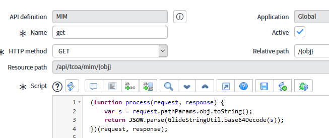

Ok, finally got it.
JSON.parse(GlideStringUtil.base64Decode(s))

xiaix
Ok, finally got it.
