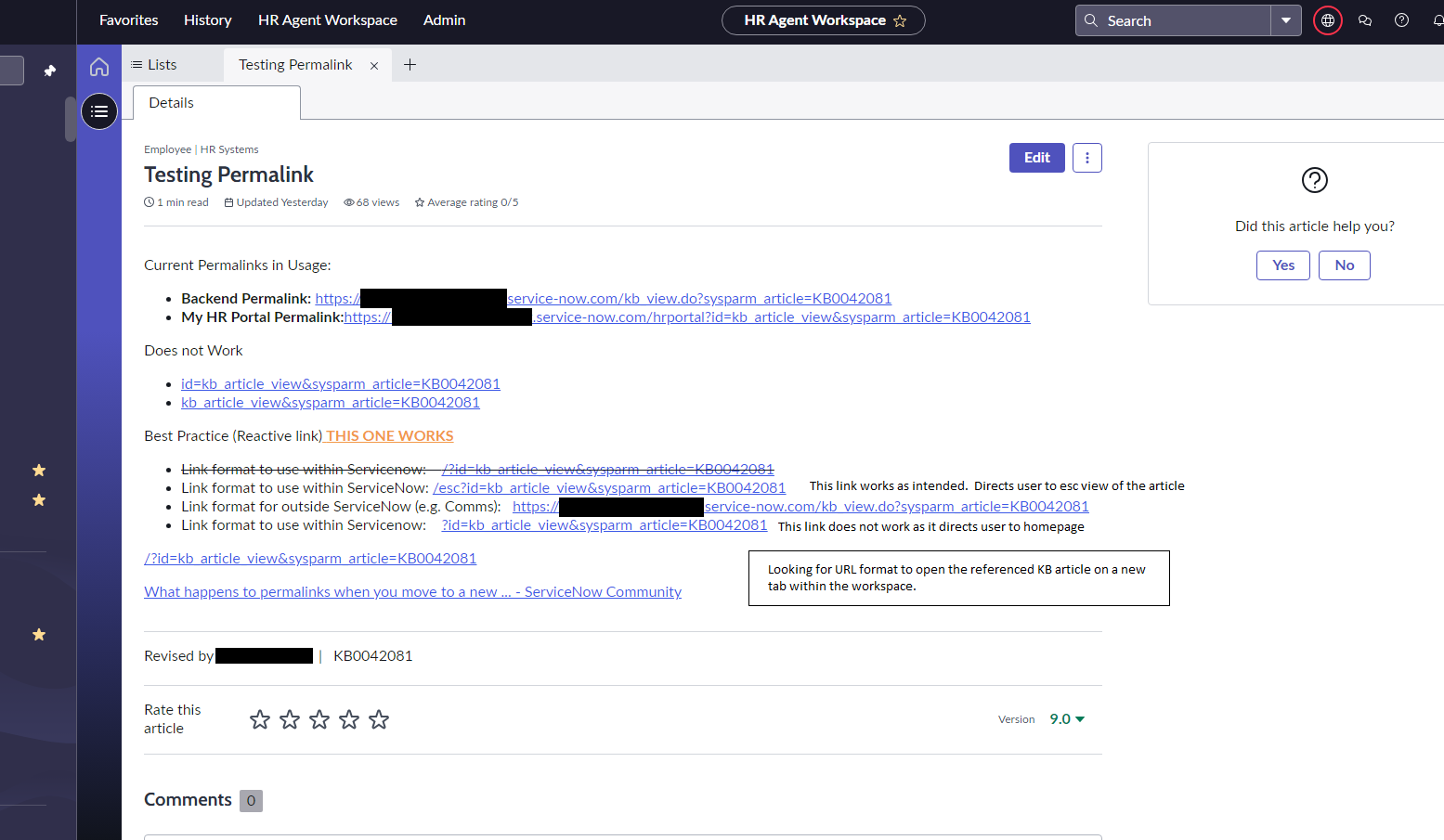

So, my question is, is there a particular format that a URL need to be when accessing within workspace that it would open into a new tab within the workspace itself (not a new browser tab)?  We could modify the href command to be
href="/esc?id=kb_article_view&amp;sysparm_article=KB0033675".  This works but it sends us out of the Workspace.
I have attached screenshot of our testing KB article and can provide screenshots or any additional info as necessary.

I should probably clarify my ask..  We are looking for a 'universal' URL format where if one clicks an embedded link while visiting the Employee Center portal, the article opens in the Employee Center, while if one clicks on a link from the HR Agent Workspace, the article opens in the HR Workspace.
We thought we had it when using '?id=kb_article_view&amp;sysparm_article=KB#######', but that doesn't work if the like is clicked from Workspace.   It seems that to work in Workspace, it needs to be in a format like '/now/hr/agent/kb_view/kb_knowledge/...=KB#######'
