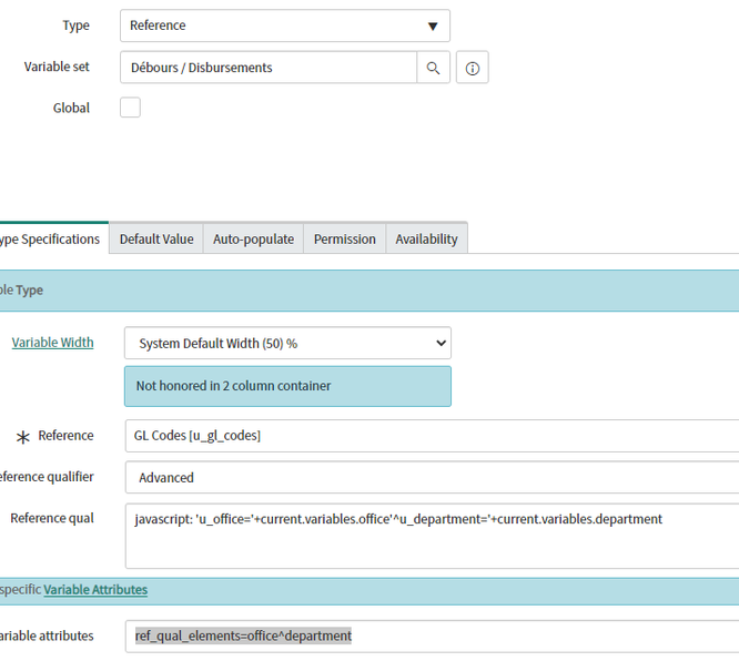

Good day,
i have two catalog item variables called office and department. These are reference items going to the cmn_location and cmn_department tables
I have an MRV that is linking to a custom table call GL codes. The columns for office and department is also link to the cmn_location and cmn_department tables.
the variables on the gl table is called u_office and u_department
When the user select their office and department i want the GL codes to be filter base on those option
i have this so far got the GL code reference in the MRV
Reference Qual:
javascript: 'u_office='+current.variables.office'^u_department='+current.variables.department
variable attribute:
ref_qual_elements=office^department
the GL codes are coming back with everything listed in it

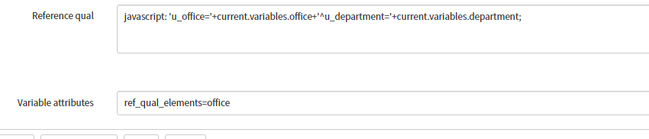

05-25-2023 10:24 AM
Hi @Peter Williams ,
Can you change the advanced reference qualifier to below. I think there is a syntax issue
javascript: 'u_office='+current.variables.office+'^u_department='+current.variables.department;
05-25-2023 10:26 AM
ok so now i am getting no records found
05-25-2023 10:28 AM
Try with a combination of office and department you know which will return records in GL codes table
05-25-2023 10:30 AM
yeah i did i created a records specifically for Department and Office and results are the same. No records found
