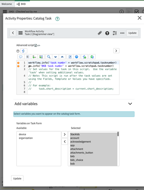

11-14-2023 02:50 AM - edited 11-14-2023 02:52 AM
If this Catalog Item has a workflow (not flow designer flow) you need to add the variable to the Catalog Task activity by selecting it at the bottom of the activity. Also, be sure when you test that you are submitting a new request - new variables won't appear on in-flight requests.

11-15-2023 03:19 AM
I have added a new variable requested by to the existing variable set and modified the flow designer by adding the requested by from the slush bucket even after that I'm unable to see the requested by variable in the Catalog task form.
Please find attached screenshots for reference.
