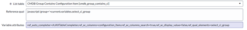

I have a list collector on cmdb_group_contains_ci table. The display column defined for the table is 'group', so the list properly displays group names. However, I need to make this list a dependency of another selector that will select a group, and have the list display configuration items of the selected group instead. This is what I have in the list collector's Type Specification tab:
The dependency part works, however, the list still displays group name for each configuration item instead of the configuration item name. Both configuration_item and group are reference fields. What am I missing?
Pasting the actual Variable attributes string here for reference:
ref_auto_completer=AJAXTableCompleter,ref_ac_columns=configuration_item,ref_ac_columns_search=true,ref_ac_display_value=false,ref_qual_elements=select_ci_group
P.S. I understand I can change display value for the table to be configuration_item rather than group, but I don't want to break any existing functionality that relies on the existing definitions.
