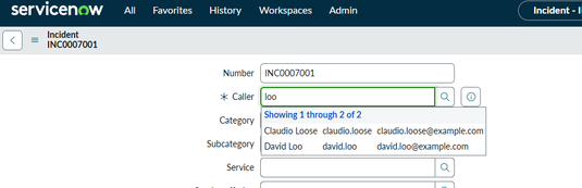

yashkamde
Hello @Abishek1998 ,
you don't need a reference qualifier script for this !
you need to add the ref_ac_columns attribute to the dictionary attribute.
from which you can search which any fields mentioned in attributes..
