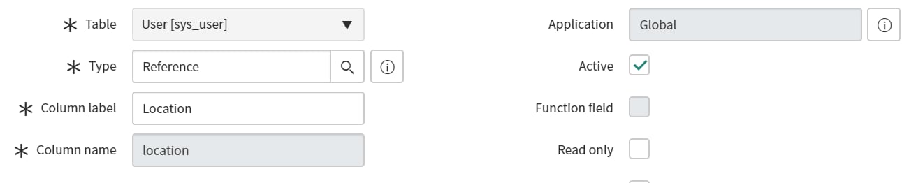

Closer I think, but still no dice. The field is empty. Should 'name' be something else? Not sure if any of these images will help, sorry for the clutter. Thanks tho, wicked fast response.
Edit: I realized your solution did work, but not in the area I expected. The location column when viewing incidents is populated now, but oddly enough when I click the incident to go in for more details, the location will be empty in there. Any thoughts on this?

Its still just populating the table like mentioned above, although I'm fairly happy about that. I think that the tables location data and the location field when you click the incident pull from different locations. Thanks for helping me get this far!
Edit: As it turns out, the location field being displayed internally was Contact.Location, which is fine for some things, but wasn't what we were changing. I added in just plain 'location', and its working like a charm.
