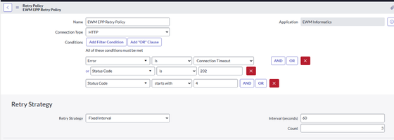

I have created a integration hub retry policy. I want to call this retry policy in script include.

The script is failing because 'sn_integrationhub.retry.RetryPolicy' isn't valid. Have you found some API documentation for this? Where has this come from?
You don't call a retry policy directly, it's referenced within a flow action
