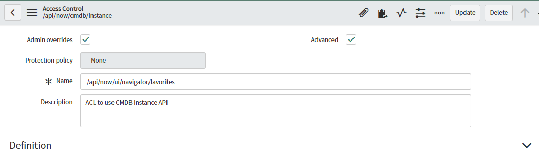

09-16-2020 11:04 AM
As a System Administrator with elevated privileges, you can create ACL as follows
Type - REST_Endpoint
operation - execute
Name - /api/now/ui/navigator/favorites
Advanced - true
Script - answer = gs.getSession().isInteractive();
Alternatively
Save and it's done!
See screenshot for reference
