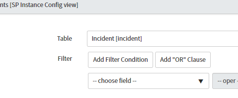

Approvals is it's own table. So that widget, by default, is set to show the user their approvals when ANY record for ANYTHING using the approvals table has a record there for their approval. So if it's not showing up for a user, then that means you may have adjusted the conditions on what records within that approval table show.
You'd want to go to Service Portal > Service Portal Configuration > Designer, click the page the widget is on (Index, I would believe) and then click the pencil icon when you mouse over the widget. Then click:
And then you'll see the filter settings which you can review and see if they are correct or not:
Then at the bottom of this same page, you'd want to double-check and see if you have a "Can View" or "Cannot View" setting set which could be hiding this from them:
