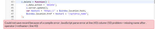

I try to add a "Delete" button on the widget "Form". Below you can see the HTML and client-side part.
However, when I try to save, I see the following message:
HTML part:
<button ng-if="getPrimaryAction()" type="submit" ng-click="c.delete()" ng-disabled="submitting" class="btn btn-primary action-btn pull-right">${Delete}</button>
Client-side:
var c=this;
c.delete = function() {
c.data.action = 'delete';
c.server.update();
var hosturl = 'https://' + $window.location.host;
$window.location.href = hosturl + "/sp?id=sc_home";
Any ideas why I can't save it?

Hello @Smith Johnson
var c=this;
$scope.c.delete = function() {
c.server.update();
08-05-2023 01:48 AM
thanks it worked 🙂
