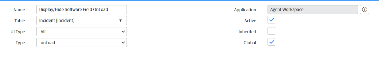

I am working in the Agent Workspace area and am trying to recreate a UI scrip that functions in our ServiceNow UI however, in Agent Workspace, there seems to be some difficulty and thats why I am reaching out.
On the incident table, if an Agent selects a Business Service (business_service) of Software, I need to show the software selction box (u_software) and make it mandatory.
I have this in a Client Script, sitting in the Agent Workspace application, Incident table, UI Type: All, Type: onLoad, and have Isolate script checked.
My current code:
function onLoad() {
if(g_form.getDisplayBox('business_service').value == 'Software') {
g_form.setDisplay('u_software',true);
g_form.setMandatory('u_software',true);
else {
g_form.setDisplay('u_software',false);
g_form.setMandatory('u_software',false);
I cannot get this to work. Perhaps someone out there can assist?
Thanks;
Dave
