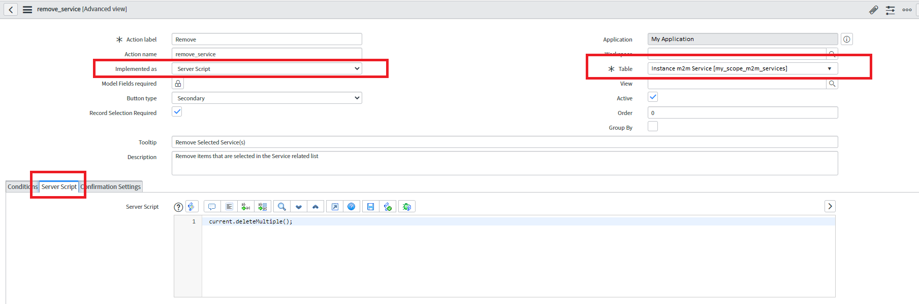

For the "Remove" button - this is a little simpler as only one entry required
5.  Add a "Remove" Action Assignment
sys_declarative_action_assignment
This is a "Server Script" with a "current.deleteMultiple()"
Hopefully with those the "Add" and "Remove" buttons will appear on related list AND load the MRA selector as a Modal.
