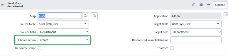

To achieve this requirement, you should create a staging table and should use the table api on the staging table.
Then you can create a transform map, which will transfer the records from staging table to the target table.
In the field mapping of the transform map you can configure to create the new choices.

Are you using a staging table & transform map or is it a POST request directly to the table?
With a staging table & transform map you can configure it to create a new choice in the list if it doesn't exist.

👍Thanks. Is it possible to set the transform map to run automatically for real-time data?
Yes, the transform map runs automatically once you insert or update the data in the staging table for every realtime inserted/updated record.
