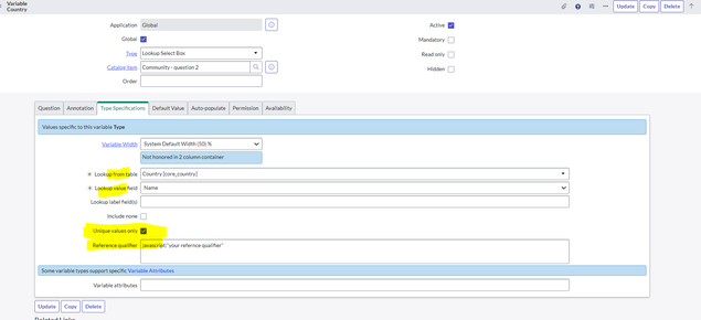

Hi @Jo_o Luis
As it's reference field, It will be difficult.
What I suggest is if possible, make the field type as "Lookup select box" & use "unique values only" option.
e.g.,
The screenshot below is just example...You can use your table & lookup value which you want to display.
Vishal Birajdar
ServiceNow Developer
- Socrates
