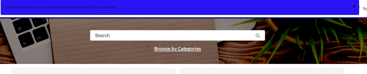

I want to change the background color to #12086f and font color to white of the below info message on service portal page. How to achieve this?

Hi @Shoheb_IbaaBoss ,
You can modify this using Portal Branding editor.
Step1: Go to https://<yourinstance>.service-now.com/sp_config?id=branding_editor
Stpe2: Select the portal you want to change.
Step3: Go to Theme colors and change Info and text colors.
I hope this will help you.

Nope, it didn't work. Still the same color.
Follow below steps this will work.
-> Open the portal you want to modify the message color.
-> Add/Modify the CSS for your required alert message with your desired color.
For example: I have modified error/danger color to yellow.
Did you get a chance to update CSS and review the solution as above.
Kindly mark correct and helpful if this resolves your issue.
