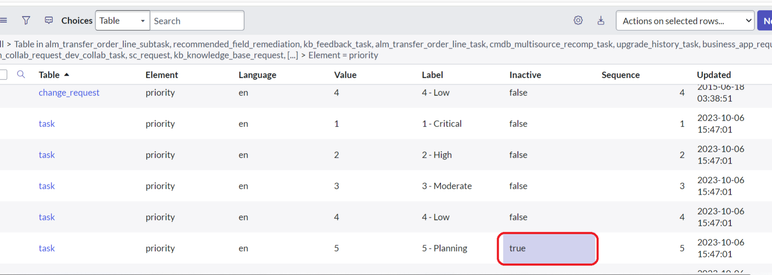

i want to remove the planning choice from  priority field in the RITM table. i tried removing it from configure choices but still its showing.

@hemasree kanduk How did you remove it ? Have you changed "Inactive" field to true for below record ?
If you are disabling it from here then it will get disabled for all tables which are getting extending from task table.
Tried this one but still its showing.
