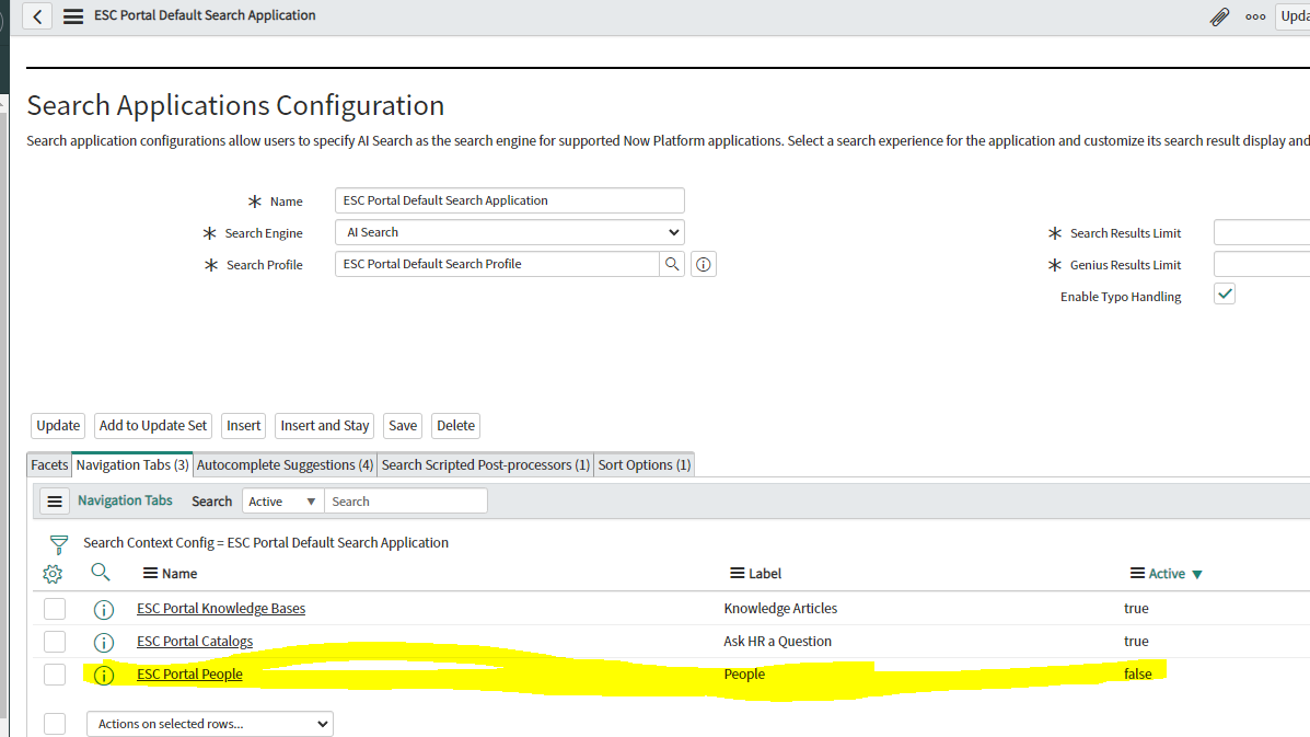

For this, you would do the following:
- In the filter navigator, type in Search Applications and select Search Applications under AI Search
- Now select the name of the search we are using, (for me) which is ESC Portal Default Search Application
- From there, you should see tab in the middle of the form and select Navigation Tab
- Under the Label column and Active column -
- Change ESC Portal People to false
Note: This all depends on which search application you are using. But should be the same process.
Let me know if this works for you!
-Rob
*Please remember to mark the helpful and/ or correct replies for your post*

Hi Rob,
Thanks for the help!
