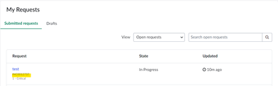

Widget "My Requests" is not redirecting to the form level when we click on REQ from portal.
11-19-2024 10:29 AM

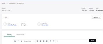

We are using OOB "My Requests" Widget on the Employee Portal Which is working as expected when we click on the incident record which eventually redirects to the form, However when we click on the request record it does not redirect to the form. Please see the below snip for the reference. Kindly help us on it!.
For Incident,
When I click on the incident it redirects to form view as follows,
But For REQ,
when I click on the REQ it is not redirecting to form view,
--> It again redirects to the same page and not opening the form.
