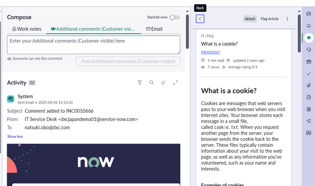

  1. When performing a contextual search on the Incident form in the Platform and clicking the "Attach" button.
  2. When using the "Attach" option within Agent Assist in Service Operation Workspace (SOW).

yes as per my knowledge only those 2 places.

Kb_use is populated when article is directly viewed, attachment is viewed, if it is viewed in portal, if it is viewed in native view.

Whenever an article is viewed from OOB article view page like kb_view or kb_article_view page, system increments the sys_view_count field for that article and at the same time an event is raised to add a row in kb_use table.
