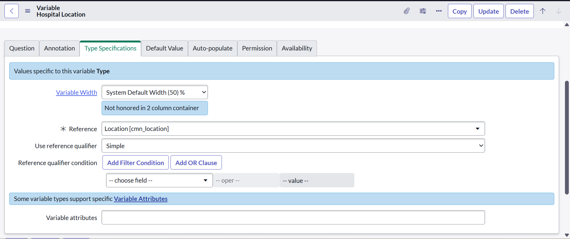

I have created a work order template (record producer) for which there are 3 variables - contact from user table, hospital name from account table and hospital location from location table. I am able to populate logged-in user's name, account but location is not being populated like it is showing there are no records in it.
I have referenced correctly with table. For reference, I have tried FSM Implementation e-book lab 6.6.1 but also not able to get it.

Can you try it in csm portal and inform? It's working fine when we "Try it" in record producer. But when I try in portal, its showing no matches found.

I checked in CSM portal in my PDI the data is visible for me for location field.
As I have a admin role. But, If I impersonated with end user the data is not visible.
So, it happens because of read ACL's on cmn_location table. Please check do you have the correct role which should match with ACL's role and conditions.

There was an issue with ACL read role for logged in users.
Thank you Sourabh!!
