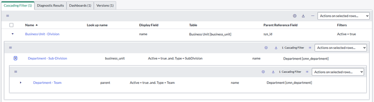

In order to filter our reports, I've tried creating a Cascading Interactive Filter with the following levels:
> Business Unit - Division
    > Department - Sub-Division
        > Department - Team
As seen here:
ISSUE
However, we encounter an issue when trying to use all three levels of the filter. This is because levels 2 (Department - Sub-Division) and level 3 (Department - Team) are both references to records on the Department table [cmn_department]. So when a selection is made on all three levels, the resulting filter is querying the reports with two conditions for the same field, which of course returns no results.

Correct, I could do that if I were manually selecting/creating those conditions on a filter within a list view. However, the query/conditions that I have outlined is what the Interactive Filter generates.
For example:
  1. I add my Cascading Interactive Filter to a dashboard.
  2. I ensure the Interactive Filter is set to target the tables that I am reporting/have reports for on that dashboard.
  3. I ensure the Reports are set to "Follow Interactive Filters".
  4. I now make a selection from each of the 3 drop downs on my Cascading Filter, and click "Apply".
  5. The Reports are getting filtered by the condition that that Cascading Filter generates, and now show zero results because the filter being applied includes:
    "record.entity.cmn_department=Customer Support" AND
    "record.entity.cmn_department=Service Desk"
So what I'm trying to understand is whether there is a way to have the Cascading Filter output the filter query with an "OR" condition as you have mentioned, instead of the "AND" condition that it currently does OOTB.
