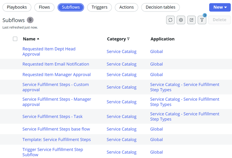

4. Sub Flow
Sub Flow can be trigger after the submission of the assessment. There are multiple not so clearly documented pre-requisite to enable this. Listing out whatever I found
- You can only do this when the assessment template is published.
- There is a purpose for a smart assessment template, under that there would be Action Category related list
- We need to set the Action Categories which are nothing but Category in the Sub flow action
- Only those sub-flows will be available to select.
- We can give the response received from the assessment, assessment related records as input to the sub flow.
- This certainly helps create an issue, remediation task, approval and whatever post submission activities required.
