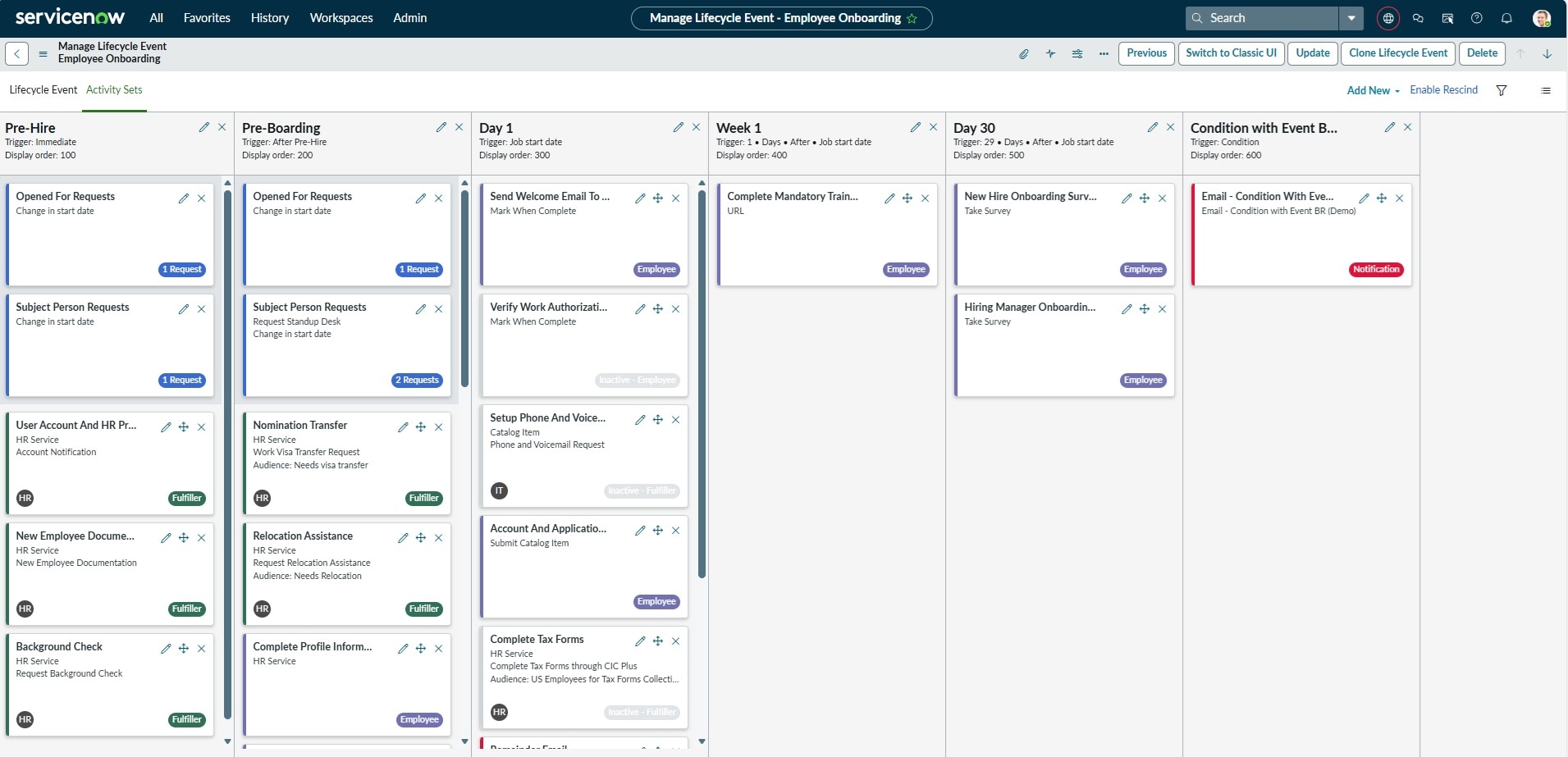

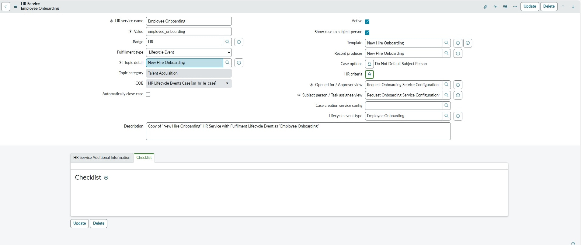

I made a copy of "New Hire Onboarding" HR Service and called it Employee Onboarding.
I made a life cycle event called Employee Onboarding. Just omitted some activities from activity sets and did not enable rescind.
I created a record producer with 25 fields exactly as in the OOTB Record Producer and copied the one line of script from "what it will contain" tab that invokes client scripts to populate a Lifecycle Event Case. I even turned off the "Turn on ECMAScript 2021 (ES12) mode" as seen in the original record producer.

In the beginning, I thought it might be the record producer, but it is looking more like the HR Service I created might be cause the issue. I am not sure what I missed.
I have attached screenshots.

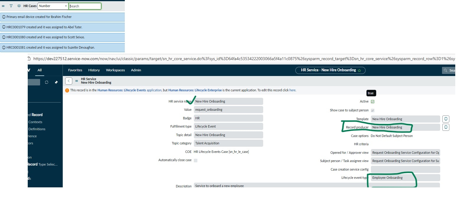

Hi @anurampalli It is my guess the name of your onboarding HR Service is the root cause. In the OOTB script include hr_CaseUtils it will create the HR Profile when the service name is "request_onboarding".  You just have to make adjustments to accommodate your use case (or HR Service name). I think that will lead you to victory.
Here is the tidbit from the script include:

Simple, yet brilliant. Thank you.
Having learned that, I will probably not mess around with OOTB utils anymore 🙂
I will create other life cycle events for my demo!
