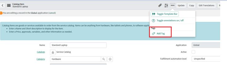

Add "Direct Deposit" deposit as tag in catalog item and the search it in portal.

@shrikantkhodke Meta tags does not get indexed in AI search. I had a same issue. Some English and Non-English keywords were not working in AI search. ServiceNow support team suggested me to move all the the meta tag to tags and it started working for all.
I would recommend you to go with Tag only.
