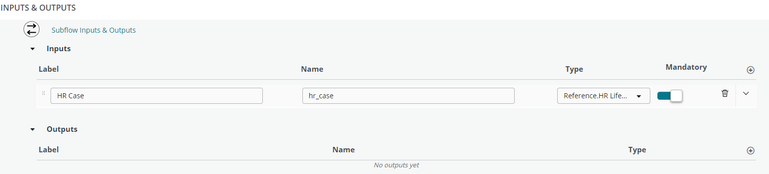

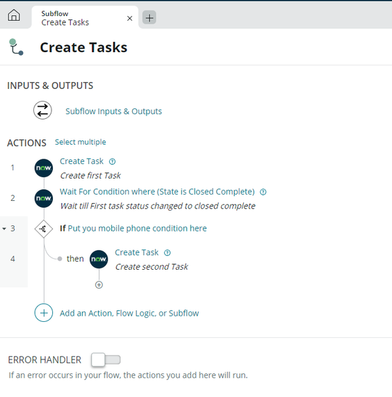

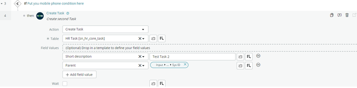

@nikhitha24 This is achievable using single subflow and call that subflow from Activity of Lifecycle event.
Subflow :
Trigger condition -
Step1 -
Step2 -
Step 3 -

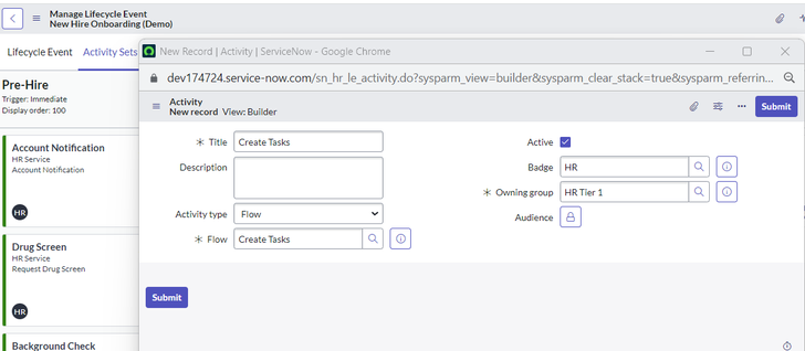

Call this subflow from activity of lifecycle event
If you don't to call it from Lifecycle event flow then you can simply create flow and above steps into it.

@nikhitha24 Why are you creating two subflows, you can create a single subflow and achieve this requirement as I mentioned above
