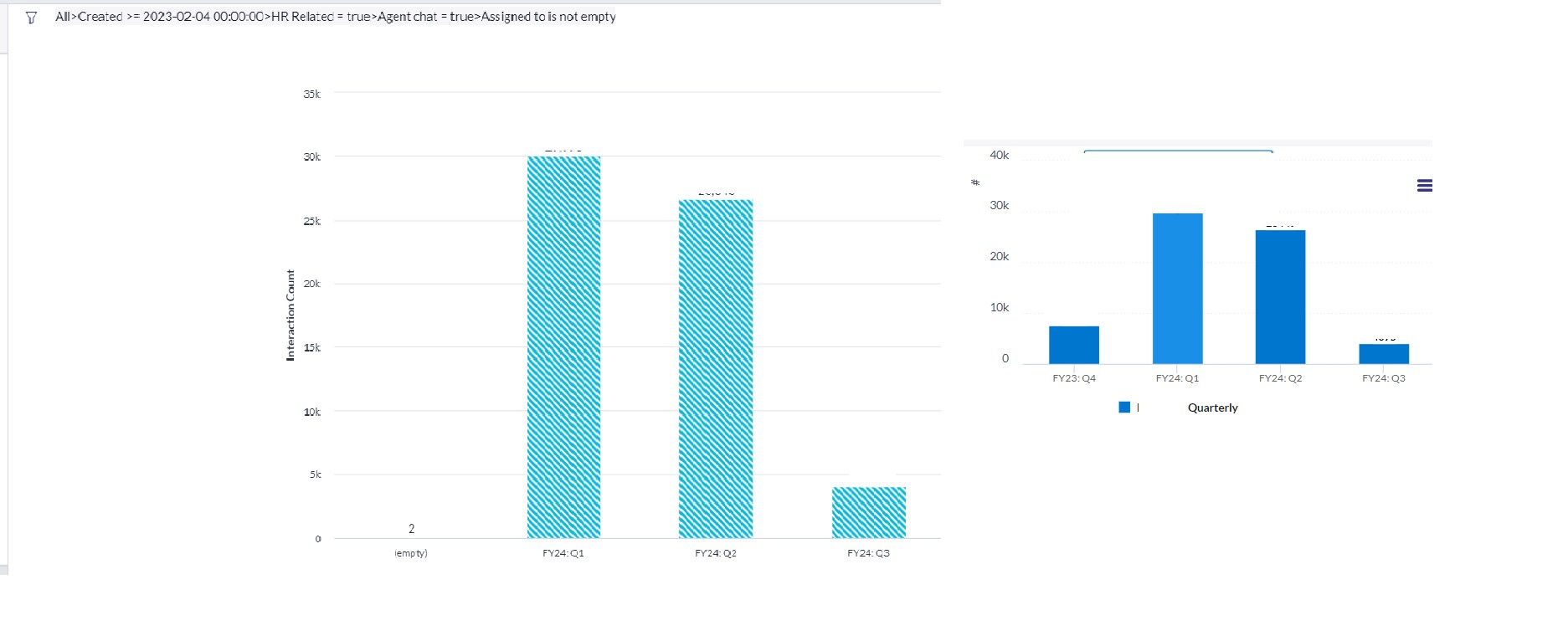

I have a question on PA indicator source (Interaction table) build with filter condition to retrive data(sys_created_on) based on fisical calendar(Quarter) and configured to pa_job run daily. Indicator source is mapped with multiple breakdowns on dashboard.
Once configured with time series widget and published on dashboard where job runs daily ,could see mismatch of data (FYQ2) while comparing with table embedded query(List view) against dashboard widget .
Query on XXXXXX table:
" sys_created_onONLast Fiscal quarter@javascript:sn_bc.GlideBusinessCalendarUtil.getCalendarStart('Fiscal quarter', '-1', 'Last Fiscal quarter')@javascript:sn_bc.GlideBusinessCalendarUtil.getCalendarEnd('Fiscal quarter', '-1', 'Last Fiscal quarter')"
To validate data accuracy new report (same query ) created and compared with indicator source exist on dashbaord , could see data mismatch .
Can I know what might be reason in difference of data , is this due to breakdown's filter while fetching data during job runs.

08-23-2023 02:28 AM
Hi Andres ,
Thank You . You are correct breakdown are mapped to automated indicators , Please find the conditions used in report and indicator .
Both report ad widget are displayed in column type.
Report Condition:
All>Created >= 2023-02-04 00:00:00>HR Related = true>XXXX XXX = true>Assigned to is not empty
Calendar: Fiscal calendar 😕 per: Fiscal Quarter
Count of Records: FY Q2: 15500
Indicator source condition:
Created on This Fiscal Quarter.and. HR Related = true.and Assigned to is not empty
Count of Records: FY Q2: 15650
Even in table list view(By query) I see the difference and matching with report data.
Could you please suggest me where can I fix or correct. Data which I have tested for FYQ2 and difference of records count observed from report & indicator source..
Let me know your suggestions and do provide more information.
Thanks in advacne.
