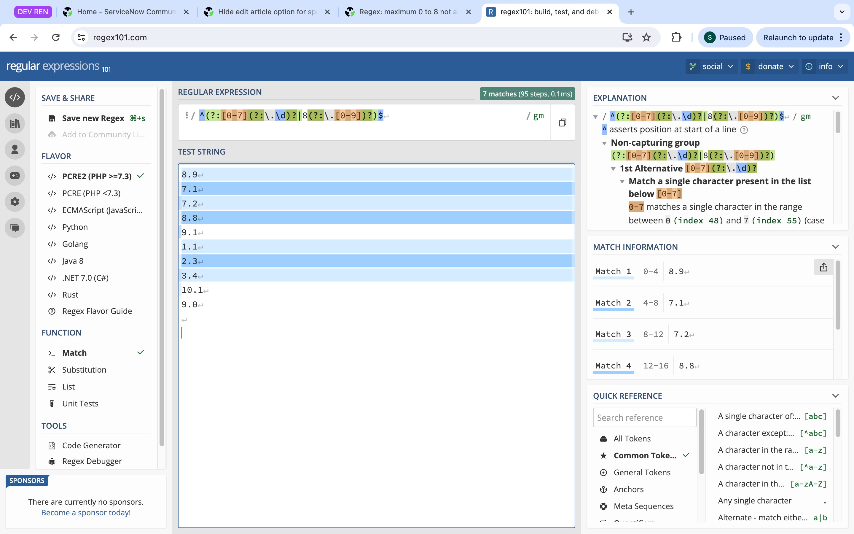

Hi @chandan31
^(?:[0-7](?:\.\d)?|8(?:\.[0-9])?)$
Can you check with this .
Mark it Helpful and Accept Solution!! If this helps you to understand .
