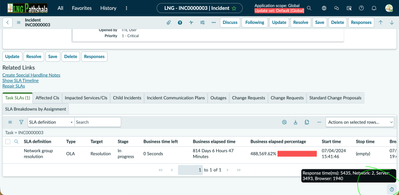

1. how do i investigate the error if a form is taking time to load in prod instance.
2. let's say you are on incident form and on right clicking the header you see the context menu is not loading how should we proceed to resolve the issue.

If it is a native form, you can check the response time and performance details to identify which script is taking the most time to execute. This should help pinpoint the root cause of the delay.
