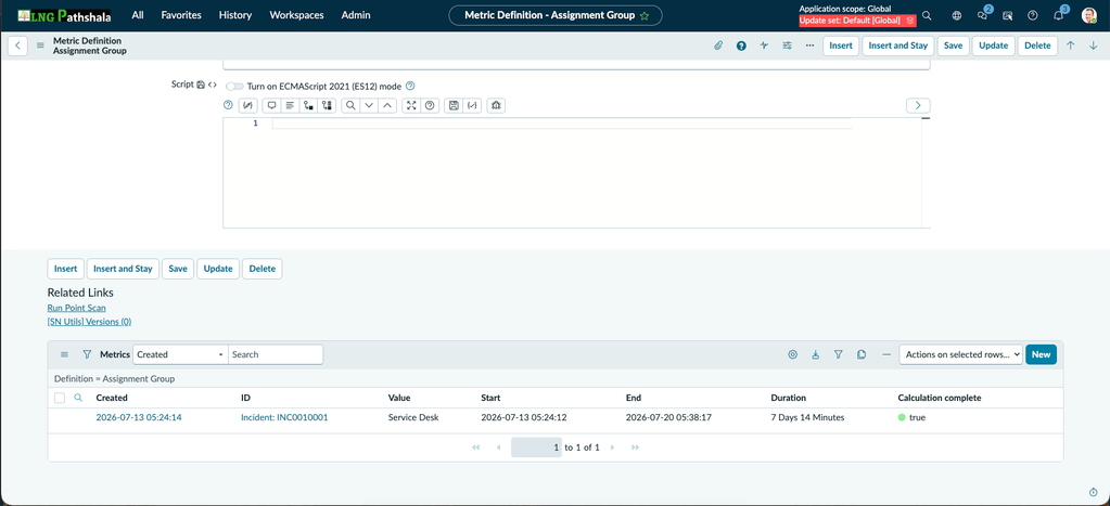

ā08-12-2026 06:26 AM
You need to create metrics for same , check ootb metrics on incident table assignments group field. You can use metric to create report too.
ā08-12-2026 06:37 AM
I found the OOB Incident Metrics [incident_metric] table/database view, and it contains records with:
Incident
Definition
Assignment Group
Value
Start/End/Duration information
I can see records where:
Definition = Assignment Group
Value = Service Center
However, I am trying to determine the correct way to identify the first/original Assignment Group for an incident.
For example, if the metric records contain:
Incident Definition Value Start
INC001 Assignment Group Service Center 10:00
INC001 Assignment Group IAM 10:15
INC001 Assignment Group Service Center 10:45
I need the report to identify Service Center as the original Assignment Group, not simply because Service Center appears in the metric records, but because it was the first assignment.
Questions
Can the OOB Incident Metric [incident_metric] table be used to reliably identify the original/first Assignment Group?
Is there an OOB field such as sequence/order/start time that should be used to identify the first Assignment Group metric record?
Is there a recommended way to report on:
Original Assignment Group = Service Center, even when the incident was later reassigned?
Can this be achieved through a standard report/database view without custom scripting or creating a new field?
Has anyone implemented a similar requirement where they needed to reconstruct the Assignment Group journey of an Incident for reporting purposes?
ā08-12-2026 06:43 AM
Yes , you can get it from metrics easily.
The record you are getting from metrics, group by incident and sort by old value. The first group of each incident will tell the first assignment group
