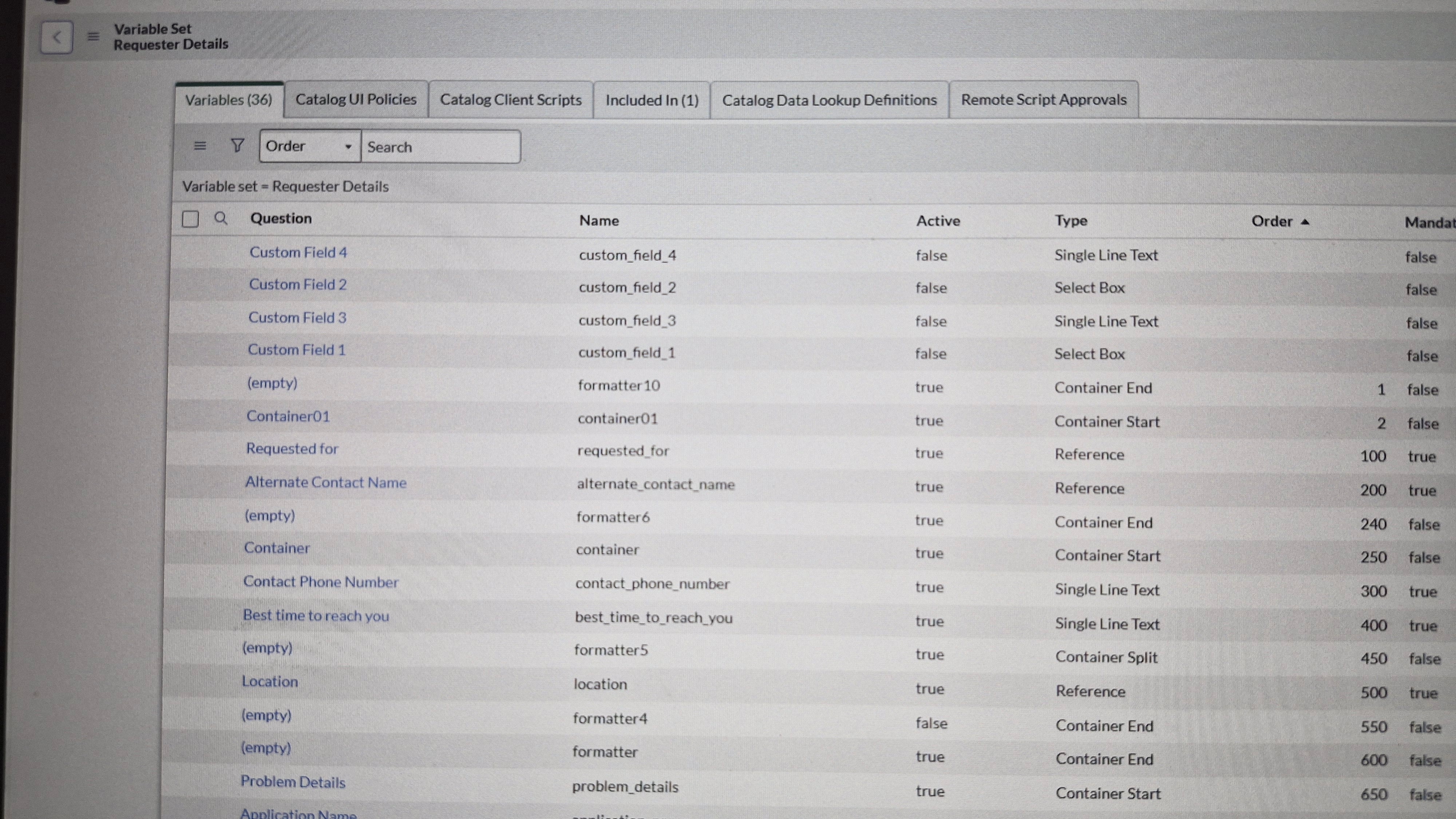

In Incident Variable Editor, when I am clicking on collapse icon some varaibles are not getting hidden.
While some variables are kidding. I have used containers. Varaible from 1st container are hiding but for other containers they are not hiding

Yeah, that will do that. You're only collapsing Container01, which contains only 2 variables. Just because you're not showing the title for 'Container' it still exists, and you're not collapsing it. You'll need to put all of the variables in the same container. Not shown in your screenshots, but it looks like maybe you want 2 columns after the first two variables. You can try another container start after the second variable without a container end first to see if the split works, then two container ends at the end of this section.
‎01-27-2026 06:50 AM
Tried to end both containers at end of 2nd container but it didn't worked
