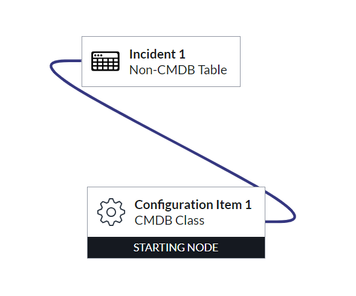

6. Search for Incident Table in Non-CMDB Tables, drag and drop it to the Query Builder. And apply the filter to Incident table as "Priority is Critical"
7. Click on the Configuration Item Query Builder(a node will appear) , click on the node and click on Incident table query builder and click on the node as shown below. A connection will be established between two nodes.
8. Save and Run the Query. Remember to allow pop-ups to get the query results. A new tab will open with the query results. I got results as 6. Enter 6 in the description field in Previous tab and save the query. Validate the task.

Step 7. Make connection in Configuration Item and Incident Class as shown in below Diagramstep 5.png
Step 8. Now Save and Run the Query and Instance will direct you to another Screen where you can view the number of records and you have to check that Number and paste the number in the Description of the Saved Query on the right side of the screen as below:
Your Task will be validated successfully.
