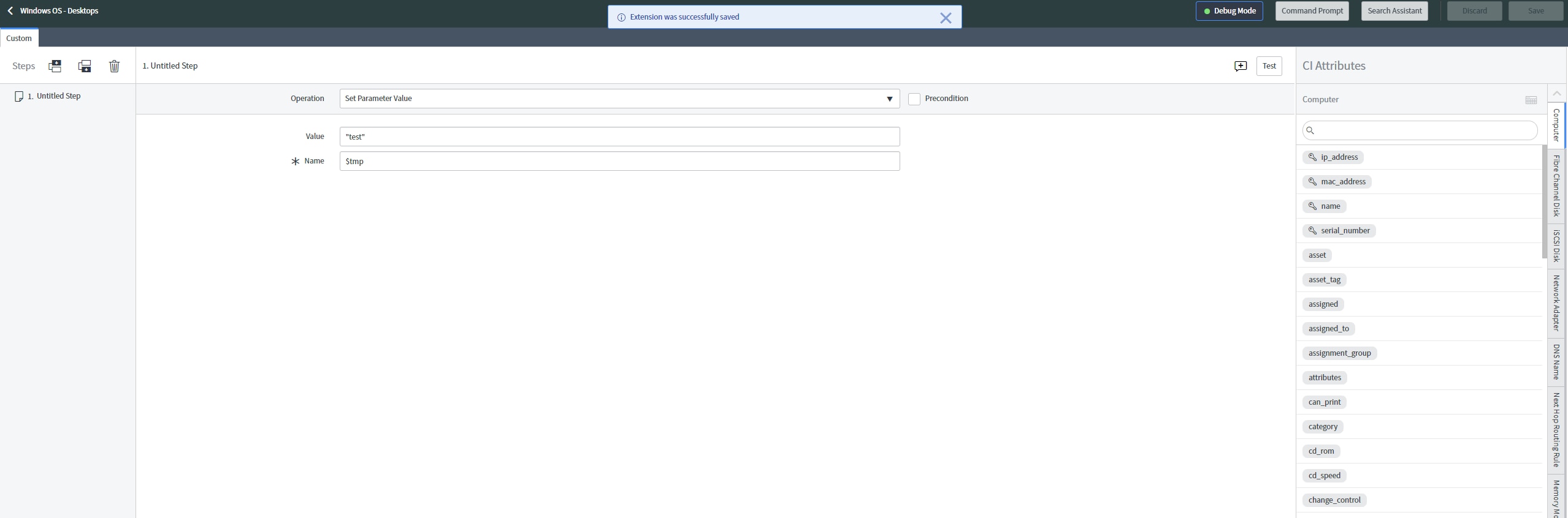

Could you please post a screenshot with what you tried in extension section.

Hello, of course!
If I remove the extension section, discovery works perfectly normal. But I really want to add more information to discovery 😄

Hi @Fredric Melchersson,
I don't see any issue with this step but however it is just setting the temporary variable.
From the error it looks like the pattern is not synced properly.
Just go back to pattern main page and see if you have published the pattern and after publishing do a sync to mid and then try discovery.
If you still get any errors, please share the screenshots of the error from the discovery log.
