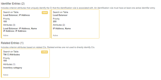

Check for OID defination , set them based on name, ip
check for identification Rule
Delete Existing CI and re-run discovery

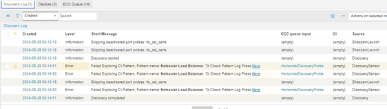

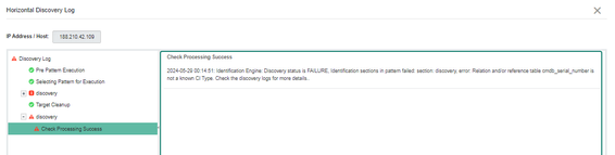

Below attached the discovery status and error log.
Please suggest accordingly.

can you go to cmdb serial number table and delete the all assocaited serial number of the IPs which your discovring for Load Balancer and try again ?
i have fixed similar issues in past but need to recall, let me know how it goes...
