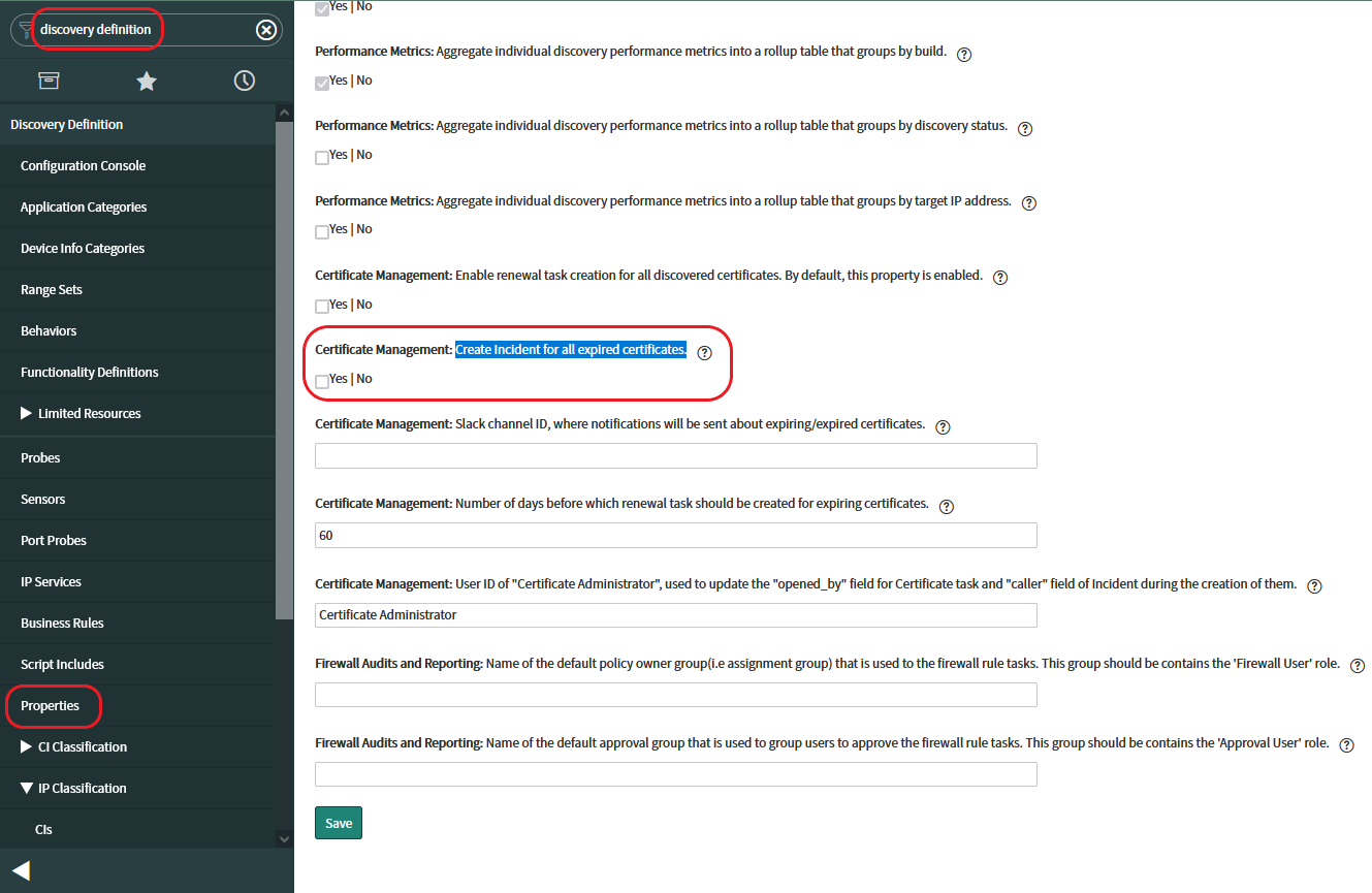

You can enable/disable the property at https://yourinstance.service-now.com/nav_to.do?uri=%2Fsystem_properties_ui.do%3Fsysparm_title%3DDiscovery%2520Properties%26sysparm_category%3DDiscovery

It appears that the incident creation is done within a Flow Designer Subflow titled "Certificate Notification." The scheduled job "Certificate Notification" calls a script includes title "CertificateTaskNotifier" which executes the Subflow on line 19.
Within the Subflow if the certificate is found to be expired (Step 13) and the system property for incident creation is true (glide.discovery.certs.enable_incident_creation_for_expired_certificates), then the incident is created if one for that specific certificate CI does not already exist.
I believe you should be able to modify the system property to a false value to prevent the creation of the incidents for expired certificates.

Thank you so much. I can't believe I didn't look there!
Happy to get you moving in a good direction! Thanks Rishi for providing the UI-version and making it even less complex to resolve!
