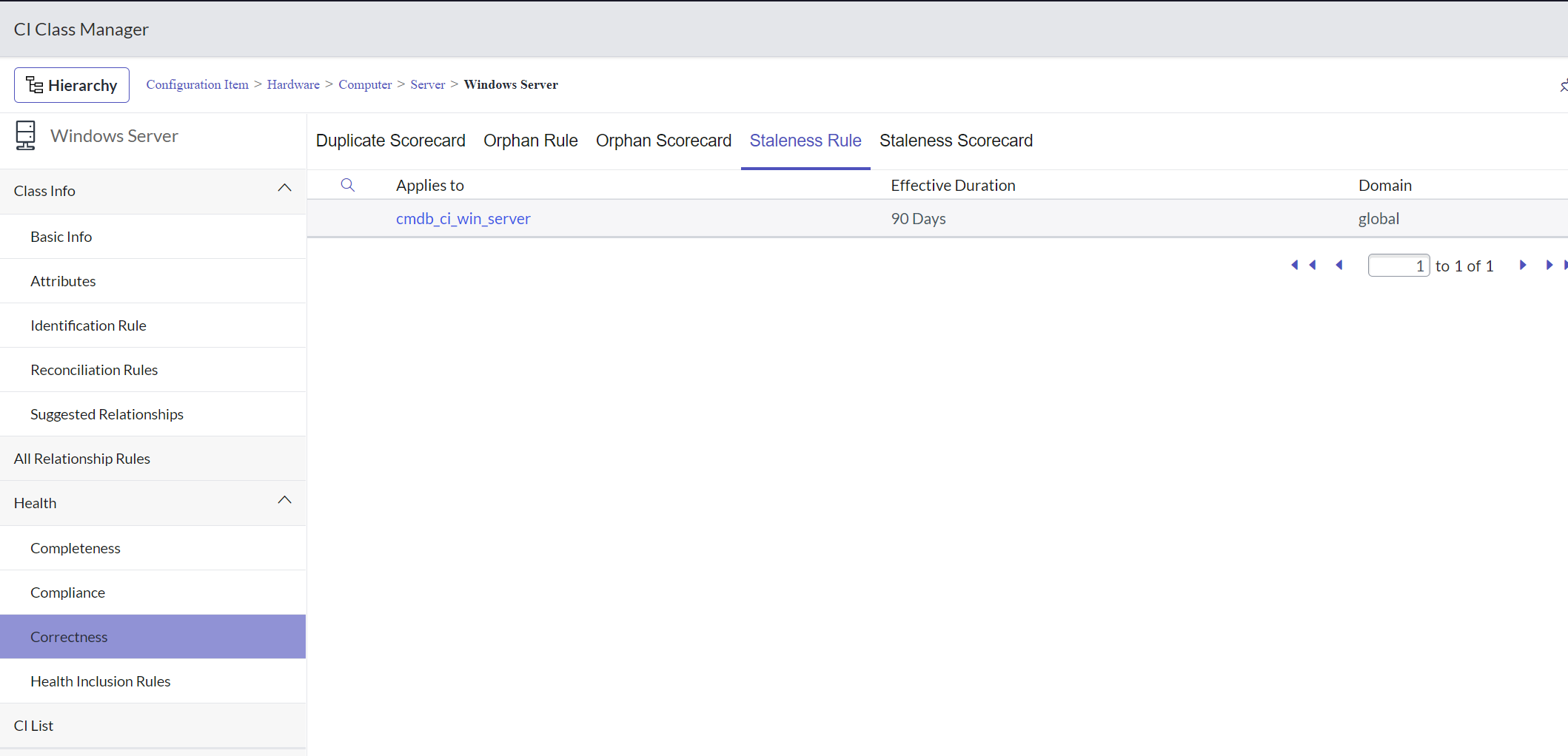

To accomplish this you will need to do three things:
1. Set the Staleness Rule for the Windows Server CI Class to 90 days as below:

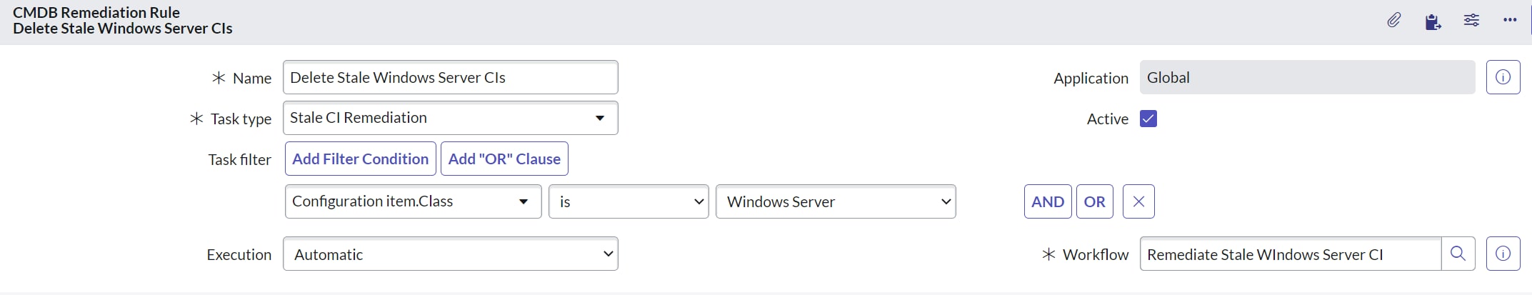

2. Create a workflow to delete the Windows Server CI if it's stale
3. Create a CMDB Remediation Rule
Also, make sure that the Create Task option below is turned on for staleness rule, otherwise the remediation task will not be created:
