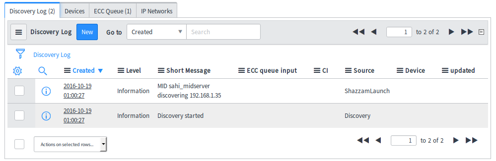

(0 / 0 - The job isn't even starting, so the mid server never even gets any work to do. Something is going on with this instance.) i have the same issue what is the problem with my instance?? why my discovery is being struck ?? before it was working .doug.schulze
If you have done your due diligence in troubleshooting the midserver, upto and including re-deploying , Id have to humbly suggest talking to support..
