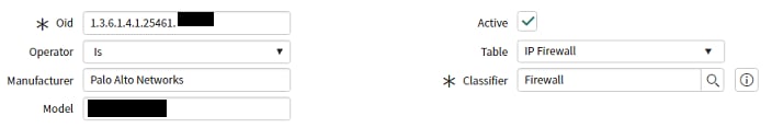

Fourth - so if the Quick Discovery Completed activity ends with Active, couldn't classify We can try again by adding the sysObjectID as an indicator to discovery of what classification to use for this device. sysDescr might have model etc. and in this case, the generic classifier put enough details into the CI that I didn't have to any additional discovery components.
  1. in Filter Navigator type in 'SNMP'
  2. Discovery Definition...CI Classification...SNMP
  3. search for Name = Firewall <-- this is this is the OOB SNMP Classfier for Firewalls
  4. on Related List Tab SNMP OID Classificaitons you can click NEW
  5. oid field = 'oid of device'  from above
  6. Manufacturer = Palo Alto Networks
  7. Save (it should look like below)
  8. Re-Run Discovery for that IP
  9. The CI should now be classified and created
  10. Review the CI for expected details (model, serial number,etc)
Hope this helps
Marc
